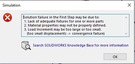

As a part of the thesis I have to find the hotspot stress in a chain laying over the stern of a anchor handling vessel. (See case2.JPG and chainONfairlead_1.JPG). Alpha and phi is to be the same angle for the picture below.
I also need to simulate a straight chain under the same tension, to compare stress distributions.
The simulations need to be non-linear, as we expect to see stresses above yield and parts moving (in the chain over stern simulation). The material model uses "Plasticity - von Mises", but for some reason does not start with this when you open solidworks. Material data can be found in Chain.pdf, where dimension is 76mm and steel grade R4.
As of now, I have only managed to run a simulation of a straight chain with 3 links and the results here look good. When I've tried to add more links, the simulations have collapsed (error2.jpg).
