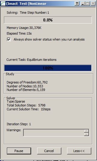

Im a little confused and I am wondering if anybody had a similar problem:
I'm trying to solve a nonlinear dynamic analysis (impact w/ an initial velocity).  Everything was working grand until I lost all my work.  When I tried to recreate my previous results, I cannot get the solver to solve correctly.  I want it to run for 5798 timesteps, but it skips (to the best of my knowledge) 5,045 timesteps.
Did I define something wrong?  Is it pulling junk data from some temp file?  or is this just another flaw in solidworks?

i'm not sure what you're trying to show here
did you restart a simulation?
did you remesh and rerun it?

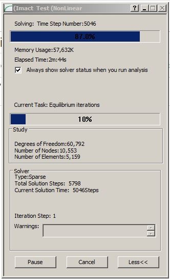

Hey Jared,
What I was trying to show was that at timestep "1", it displayed a timestep of '1' (0% Complete), but at timestep "2", it displayed a timestep of '5046' (87% Complete)
It appears the form got contaminated; in the background, it WAS incrementing correctly but wasn't updating the msgbox correctly.
I don't know what caused it (and restarting, remeshing didn't affect anything) but it disappeared after I made several changes; the only noteworthly one being the change of the mesh type from curvature to standard.

where is timestep 2? it says time step 5046
AD
AD 2015-04-22
lol, there is no "timestep 2". Now you know my confusion and panic.
If you watched my computer; it would go from timestep 1 to timestep 5046.  After some time of waiting, it then proceeded from timestep 5046 to 5047 to 5048 to ...
