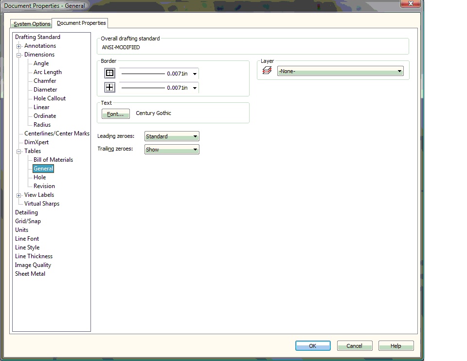

I have a General Table in a tabulated drawing. In options the selection to show trailing zeros is set to show for General Tables.

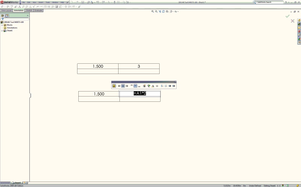

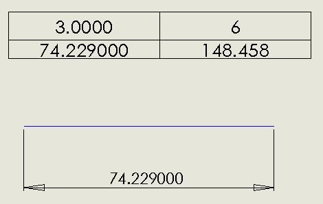

I have several equations in the table however the figures the equations display do not include trailing zeros.
If the equation result is 4.000 the cell will only show 4
