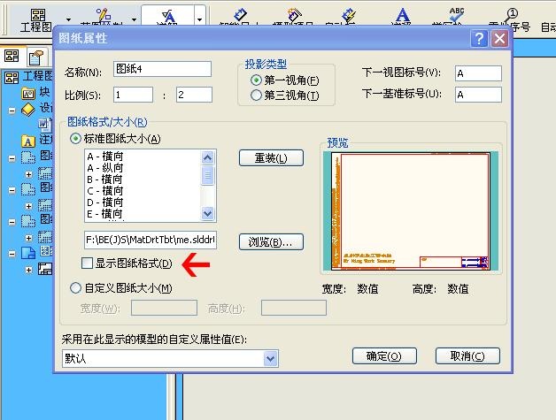

NewSheet3 in Drawings of the applications of the limitations
if you MACRO record.
Result

Questiong
Part.SetupSheet4 "图纸4", 12, 12, 1, 2, True, "F:\\BE(J)S\\MatDrtTbt\\me.slddrt", 0.42, 0.297, "默认", True --- It's Error
Part.SetupSheet4 "图纸4", 12, 12, 1, 2, True, "F:\\BE(J)S\\MatDrtTbt\\me.slddrt", 0.42, 0.297, "默认" ' Remove  ', True----
Result
The solution is to manual in the front place tick
SolidworksApi macros
