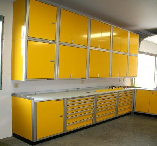

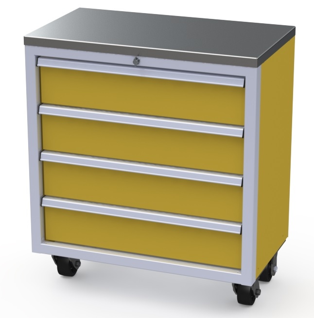

I just started using PV360 the other day to somewhat render some of our products and I am having one heck of a time trying to get a yellow rendering to look like our yellow. It seems to always look a little green and under the weather. I have a pretty good feeling it is a lighting issue and perhaps a material issue.
What I have done:
*Tried several different materials and surface finishes
*Tried every oem lighting scheme and "backdrop studio with fill lights" seems to make most everything look about right with all the other colors.
*spot lights seems to make it look a little more yellow but then really messes up the frames and the countertop
* I have changes gama to 1.3 t
* I toned down the intensity of the spotlight
* made a custom swatch from a tif of our actual product
* I have tried to pay attention to my layers of color and material. I take all appearances away when trying something new
