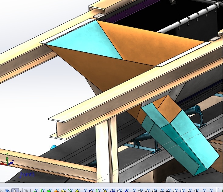

I have designed a simple hopper that will rest between two structural beams. The hopper will utilize some formed brackets that will rest on the top of these beams. What i would like to "Study" is the amount of stress or fatigue the brackets will experience with just its own gravitational mass pulling it down. Ive tried a few things but have not had any success in getting a result.

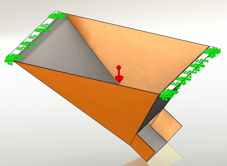

Thus far i have made my "fixture" the two bottom faces that will rest on the beams and made my gravity the top plane of the model. I get a good mesh , but when i try to run the analysis i either get an error about inadequate relations (ive tried the soft spring and inertial releif ) or it just simply wont solve.
Any suggestions ?
