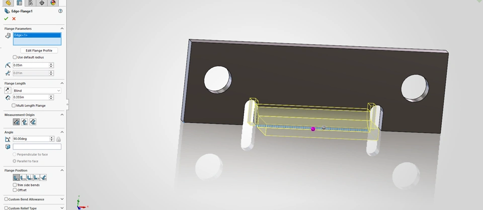

New to sheet metal, how do I not take this little chunk of material out when adding a flange?

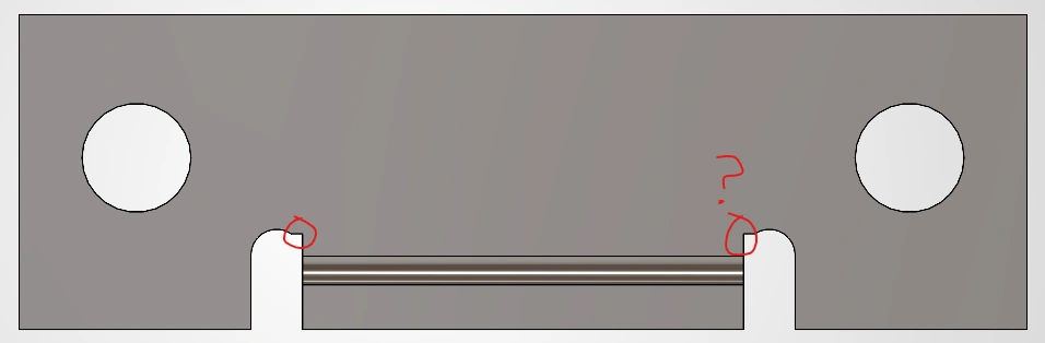

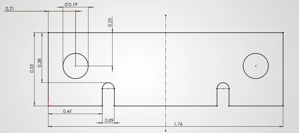

Hi, I'm trying to make a little sheet metal part, nothing too crazy, but when I apply this flange edge it cuts away a little bit of material, and I'm not sure why. Any idea why this is being taken away? This is the basic sketch of the base flange:
Making it into a sheet metal piece:
And then I applied an edge flange at the bottom, between those two slots:
I see when editing the edge flange feature, it has these yellow boxes where it's cutting out excess material, how do I make it stop doing that? Is it as simple as cutting the first sketch area back a bit and then changing the flange position in the edge flange feature, or is there a simpler way to do it? Thank you for any help!
