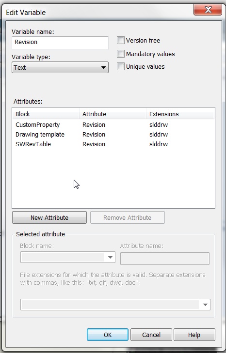

I am trying to get the new revision link with PDM up and running, now everything looks to be fine.

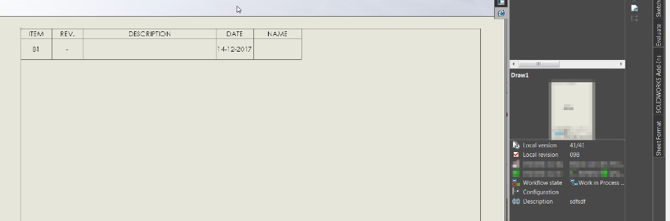

Bu the revision isn't shown in the table it only shows the placeholder.
I think I have set it up right, and the revision shows correctly in PDM and state changes work correctly.
Local revision number is equel to pdm revision. I am using the default revision table.
Anyone any idea what I did wrong?
