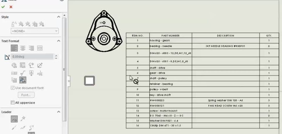

Hello All!
Has anyone tried the new Link to Table Cell function for inserting bom items into notes? Out of 4 computers here all running SW 2017 Pro with Win 7 Pro, only mine will allow the user to pick a cell in the bom table when using this function. After contacting my reseller about this, I copied my settings to one of the other computers and the link to table cell function worked. But, that doesn't tell me which setting is causing the problem. My reseller says they can't search two settings files for differences. Any ideas out there as to which setting may be keeping this from working? I'd rather not force the other 3 users here to use my settings just because of this problem. Thanks!
