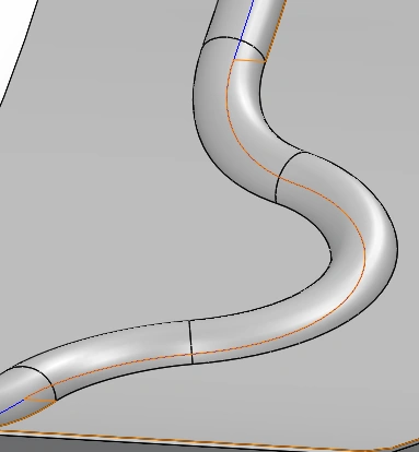

Howdy again! Currently working on this curved plate thingy, and there's an issue with this sweep I just can't figure out how to fix.

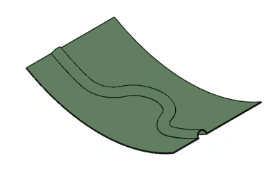

(Bottom image is part I need to make, top and middle is part I'm currently making)

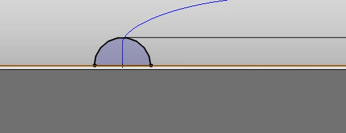

Notice that when I highlight the edges of one of these faces, there seems to be a slight gap between the sweep and the face.
Big issue, and bigger when I try to do the cutout! The profile's bottom line needs to conform to the plate all the way through.
