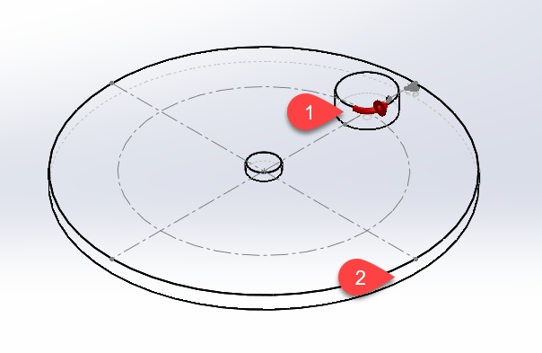

I need to create 144 trace paths so I can export the data, find the maximum distance from the center of all of the paths, and then re-import the data to create some geometries.  Sound like fun?  It isn't  - it's completely mind numbing.  And I want to automate it because I'm not sure we have the correct intial positions of all the bits that are being modeled - so I will probably need to do this several times.  Yeah!
So here's the layout.  I've got a platform (1) electronically cam'd to a turntable (2).  Don't ask me how I got that to work - I can't repeat it, I've tried several times - but I have a file that works.  On the platform is an oval.  I've created 72 reference points around the oval that I want to trace the path of and a tooling ring (not shown).  And why 144 points?  Because the idiots in the product group decided to taper the oval on the platform.  He's a pic of the layout without the tapered oval and a tooling ring that goes around the outside of everything.
From this post, https://forum.solidworks.com/message/976937?q=motion%20trace , I gathered you can't do a CSVExport on a trace path.  So I need to create X & Y linear displacement plots for all of the points.  I thought I would try replying to the aforementioned post to see if the guy with the original question had code that would create his plots but that would warp his original post and I'm pretty sure that's against some forum etiquette so now we're all here.
I've been beating my head against the sample code (Create Plots and Get Values Example)
trying to get it to take one of my 72 reference points on the oval relative to a center point of a tooling ring (not shown) that coincides with the center of the turntable.  Here's what I've got so far:

I recorded a macro and boy was that disappointing.  All I got out of it was here are the things you clicked on - which is where I got the 'SelectByID2' statements to point to my objects.
status = swModel.Extension.SelectByID2("Point121@tapered_oval@basic_asm_front_basis", "DATUMPOINT", 0, 0, 0, True, 0, Nothing, 0)
status = swModel.Extension.SelectByID2("Point1@Tooling Ring-1@basic_asm_front_basis", "DATUMPOINT", 0, 0, 0, True, 0, Nothing, 0)
For the 'Set type of plots' section, I changed both of the YAxisFeatureData's to TRANS_DISP type - I'm assuming that that's linear displacement?  And I changed the first FeatureData component to 0 (x?) and the second FeatureData component to 1 (y?)
' Set the type of plots
nameYAxis(0) = "swMotionPlotAxisType_TRANS_DISP"
swSimPlotYAxisFeatureData(0).Type = swMotionPlotAxisType_e.swMotionPlotAxisType_TRANS_DISP 'swMotionPlotAxisType_TRANS_DISP
swSimPlotYAxisFeatureData(0).Component = 0
nameYAxis(1) = "swMotionPlotAxisType_TRANS_DISP"
swSimPlotYAxisFeatureData(1).Type = swMotionPlotAxisType_e.swMotionPlotAxisType_TRANS_DISP
swSimPlotYAxisFeatureData(1).Component = 1
This is where it falls off the rails.  I changed the swFace type to Object because I couldn't figure out what it should be.  I've recorded many a macro and based on the SelectByID2 returns I've gotten DATUMPOINT, SKETCHPOINT, EXTSKETCHPOINT - none of which are declaration types.
' Get the entity whose motion you want analyzed
swFace(0) = swSelMgr.GetSelectedObject6(1, -1)
swFaceArray = swFace
swSimPlotYAxisFeatureData(0).Entities = swFaceArray
swSimPlotYAxisFeatureData(1).Entities = swFaceArray
' Get the plot's x-axis and y-axes values
swYAxisArray = swSimPlotYAxisFeatureData
PlotOutput = MotionStudyResults.GetValues(swSimPlotFeatureData, swSimPlotXAxisFeatureData, (swYAxisArray))
When I run the code, swFace(0), swFaceArray, swSimPlotYAxisFeatureData(x), and swYAxisArray all have some type of value, but PlotOutput does not.
I'm not quite understanding swSelMgr.GetSelectedObject6(1,-1).  In the SelectByID2 calls above, two items are selected.
In GetSelectedObject6(index, mark), if index = 1 then are you just returning the first item selected?  But doesn't the displacement plot require two objects?
I took out the output to the Immediate Window a swPlotFeature kept crashing (= Nothing).
If I can get this code to work, I'm pretty sure I can turn it into a loop to iterate through the 144 points.  However, it would be great to combine the x & y displacement plots into one plot.
Please peruse the above and let me know where I'm going wrong.
