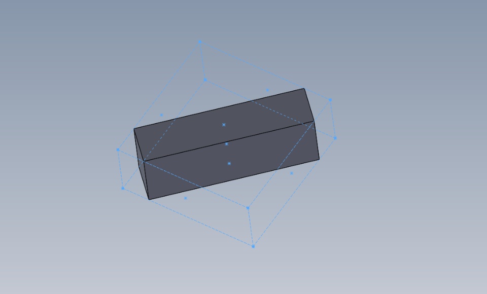

I found one good macro that works perfect with solids, however if the solid is not aligned with the axis, it gives a false measurement and that's my question. Is there a macro, or anything at all, that can give me the correct measurements? Basically I am looking for some feature/macro that creates a bounding box around the solid, rotates the box as needed, and can add those dimensions to either the Custom Property or Configuration Specific tabs.
Here is an example of a not oriented rectangle and the readings that the bounding box gives me.
