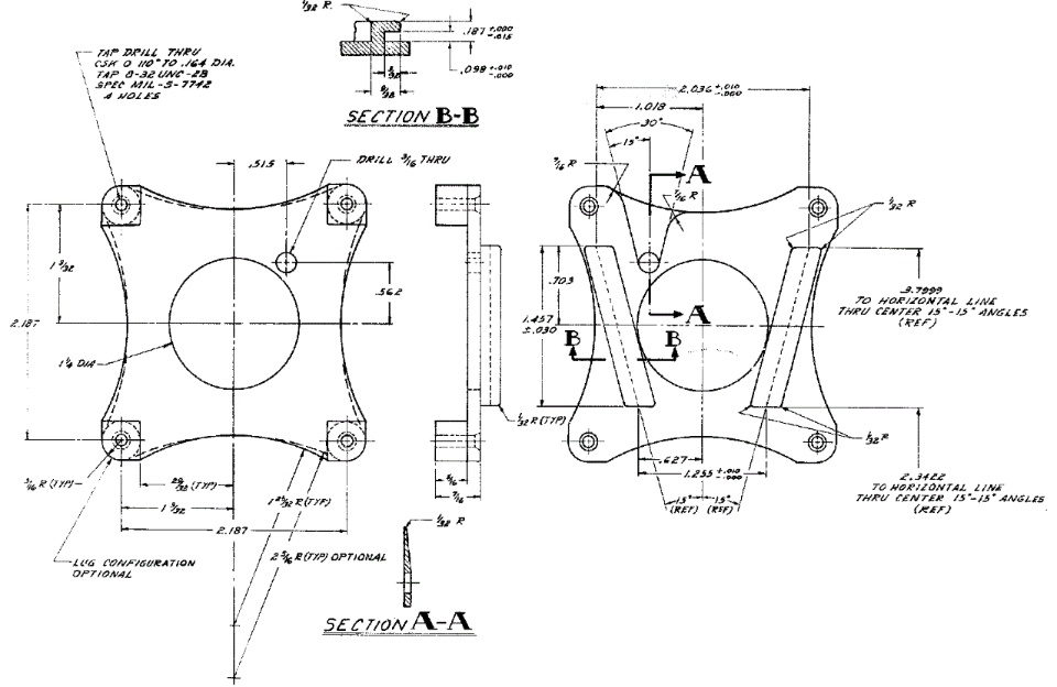

I have all of the model done except one little angled cut.  If you look at the picture below you can see there is an angled cut from the 3/16" dia hole going thru the top side (Section A-A).  I had the angle cut in but the thickness was not 1/32" all the way across the radius at the top.  How can I get the cut to have the 1/32" lip uniform through-out the andled cut.
I have attached the model with the sketch for the angled cut but no feature attached to it.
