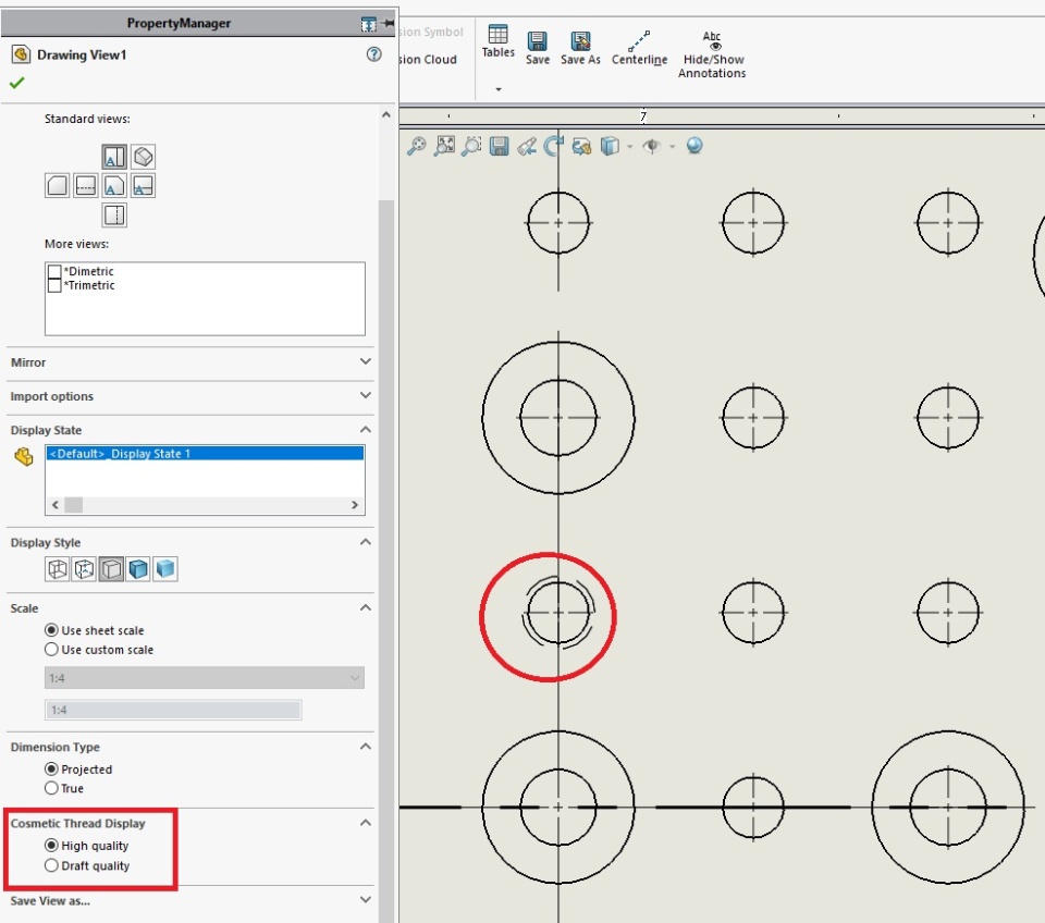

I have a threaded hole created from the hole feature. When I pattern the hole, I am unable to select the thread to add to the Features and Faces section of the pattern. It only takes the full feature of the hole, which seems fine. Visually, the holes show the threads as shaded cosmetic threads. On the drawing, the master hole shows the cosmetic thread but none of the other holes show the cosmetic. Cosmetic thread display is set to High Quality but it doesn't matter between either high or low quality. Using the Hole Callout, the holes without the cosmetic still call out the thread in the callout. Is there a setting or something I'm missing to get the other holes to show the cosmetic? Even in a cross section, only the master hole show it.
Solidworks 2016
HOLE PATTERN FEATURE (CAN'T SELECT THE THREAD, ONLY THE FEATURE ITSELF)
AFTER PATTERNING
HOLES ON THE DRAWING
HOLE CALLOUT ON HOLE WITHOUT THREAD SHOWING
DRAWING DETALING SETTINGS
