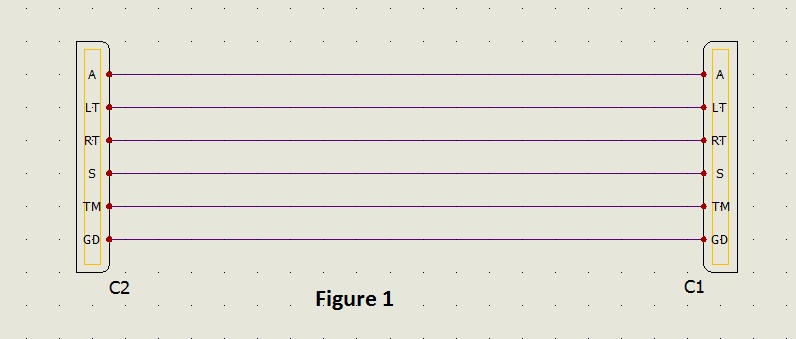

1-I make a simple scheme in Solidworks electrical 2D [figure 1].

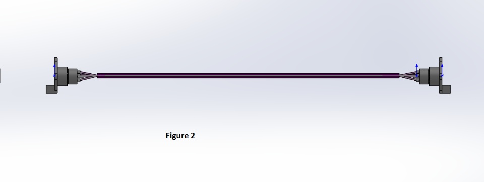

2-And I pass to mode 3D [Figure 2].

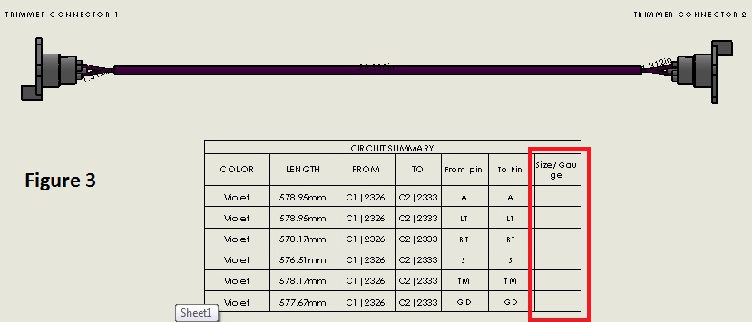

3-Then I displayed the scheme in Flatten route with circuit summary BOM [Figure 3].

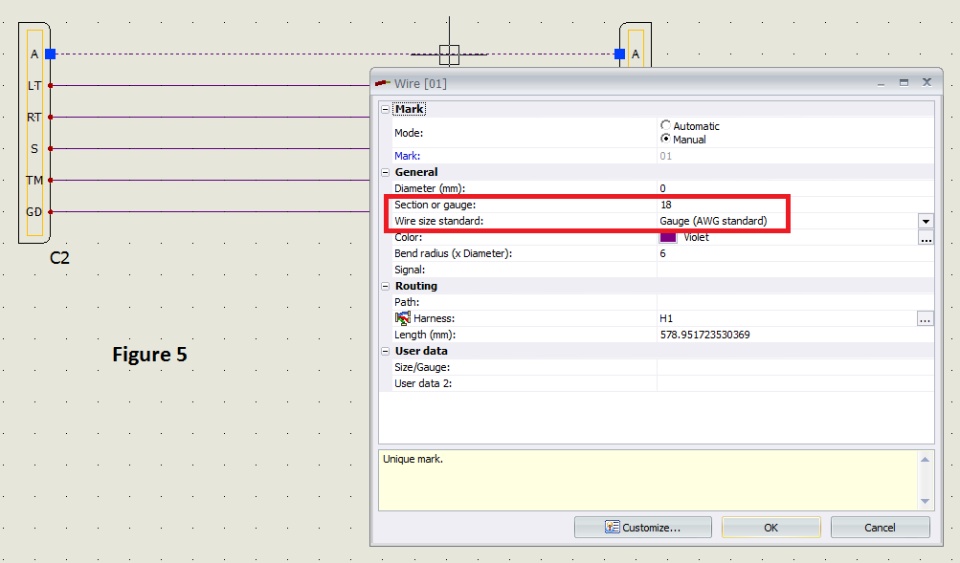

4-You Can remarque that size/gauge column does not display any value and doesn't match the table in solidworks 2 D [Figure 4 and 5].

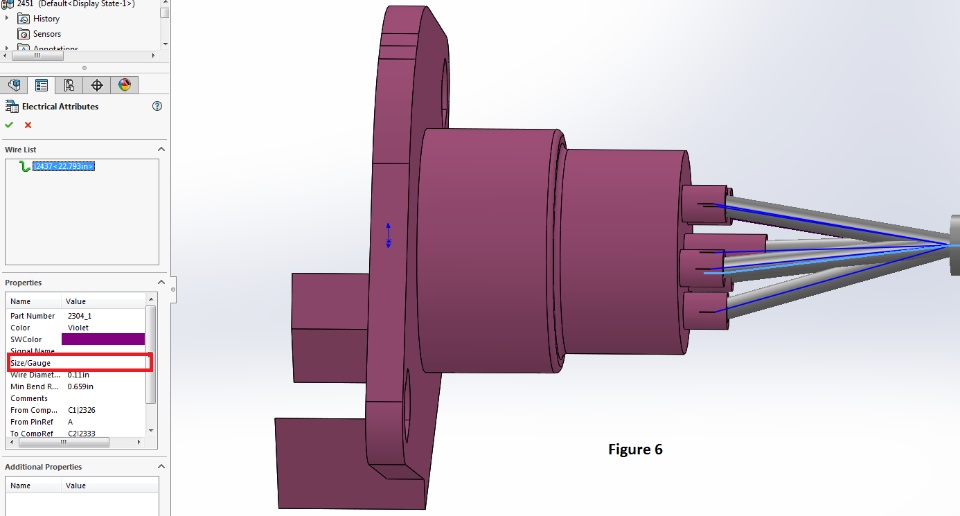

5-And when I try to edit route and click on Electric attributes, the properties don't display any size/gauge value [Figure 6].
