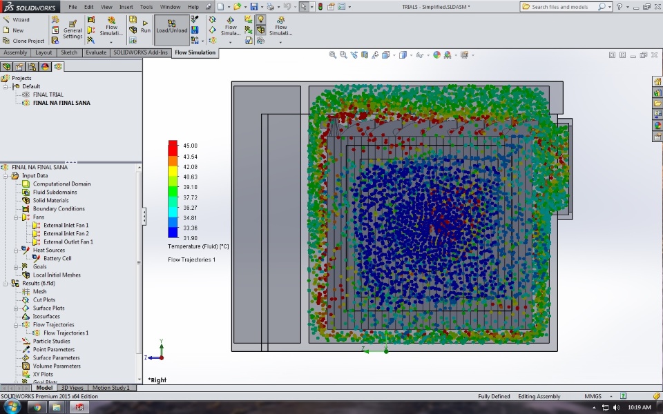

i made a flow simulation and i don't have any idea if my simulation is right. i need to verify this and learn more.
What happened here is that a 31.9C air temp. enters the enclosure (using two inlet fans) then touches or made contact with the cell battery 30pcs (total of 115W) and then the air exit the enclosure (with exhaust fan). my objective is to know the behavior of the air (check) and the temperature of the air which is shown but im not sure if it is right. and if possible i want to see the temperature of the cell battery when the air come in contact.
SolidworksFlow Simulation
