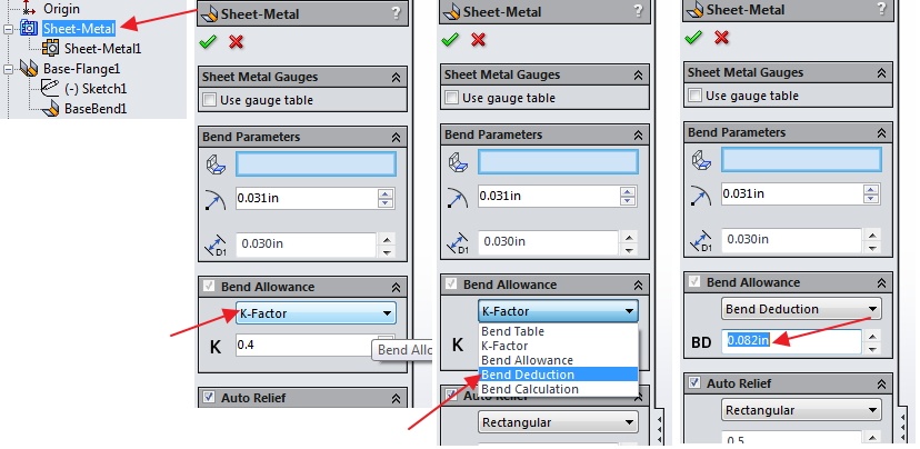

All I need is some working macro code, I can add it to a batch macro I have pre-set up, but I just need the code to change the bend type to "BEND DEDUCTION" and assign the value on a sheet metal part. I already have code to change and "overwrite" the bends individually, but I want to be able to edit the default of the sheet metal part as if you right clicked the sheet metal folder and edited the default values, it seems nothing holds or works when using a macro to do this. Help? Just a simple macro that changes a sheet metal parts defaults from k-factor to bend DEDUCTION and gives it a value. THANKS!
Added a picture of what it would do.
