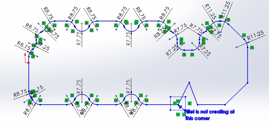

Having issue in creating the fillet as shown in below image. I need a urgent help.
Aslo I am giving the macro code created for the same below image.

'create fillet
Set swSketchSeg = swLine(0)
swSketchSeg.Select False
Set swSketchSeg = swLine(1)
swSketchSeg.Select True
Set swSketchSeg = swSketchMgr.CreateFillet(0.01125, 1)
