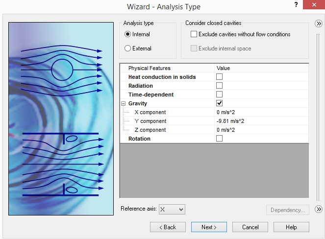

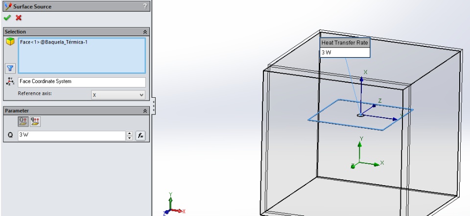

I have simulated 3 different natural convection inside an enclosure. I put a heat source inside a closed chamber. My settings are Internal analysis, air, heat source 3W, gravity -9.81m/s^2,
Under Thermodynamic parameters i changed the pressure to 101325 Pa, 50,000Pa and 10,000 Pa. Theory if pressure increase, temperature increase.

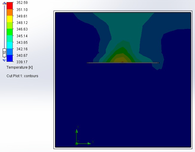

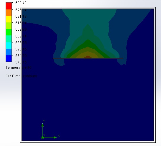

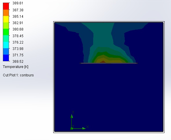

The results show the lower the pressure, the heat source increase in temperature although i fix it to 3W and surrounding temperature increased as well.
Since the pressure is low (vacuum), convection is almost neglected.i expect the heat will only concentrated at the heat source.
