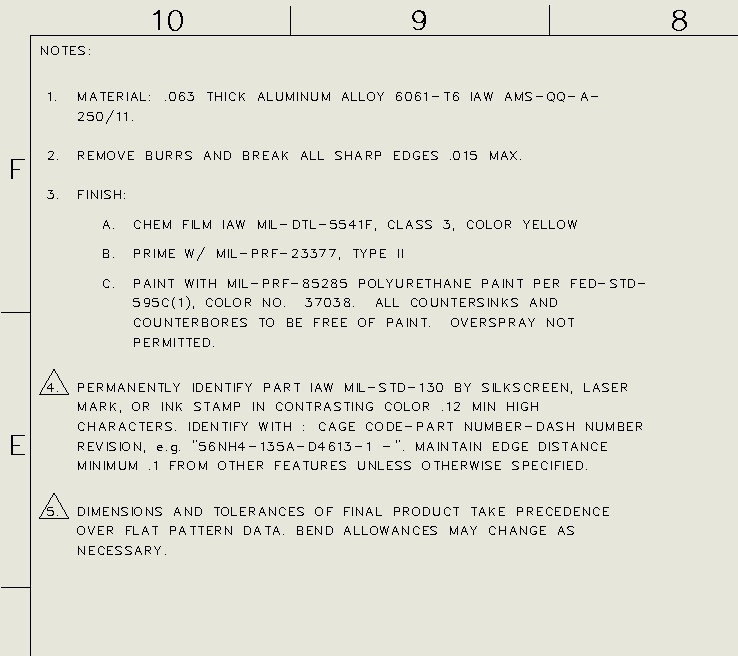

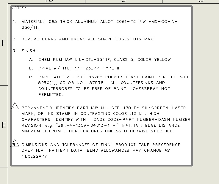

My note block enters edit mode when I save the drawing.
I have a note block on my drawings that is copied to more than 6 drawings. When I double click on it it enters edit mode:
when I click outside of the white editable note box it returns to not editing mode.
That is normal.
What is not normal is when I save the document it saves and the note block returns to editable mode (first image), or at least it looks like it is editable, but it is not editable unless I double click. If I print it the box around the note is visible.
Does anyone know how to solve this?
