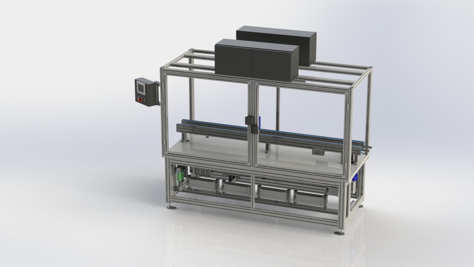

I am rendering some of our basic product that is extruded anodized aluminum.  When I render my scene the model looks way to shiny!  Is the a global setting that I can use to tone down the shiny?  Maybe an "Anit-shiny" button...?  Here is a sample of my render...

I'd edit the Scene and, under the Illumination tab, lower Scene Reflectivity.

try using a different aluminum, like the matte. or if you've already saved your own custom materials, just up the specular spread value to something between .8 and .99

Your lighting could make a difference as well.  Are you referring to it being 'too shiny' on the right side?  It looks like the lighting is not balanced as well.  The left side could use some fill lighting.
