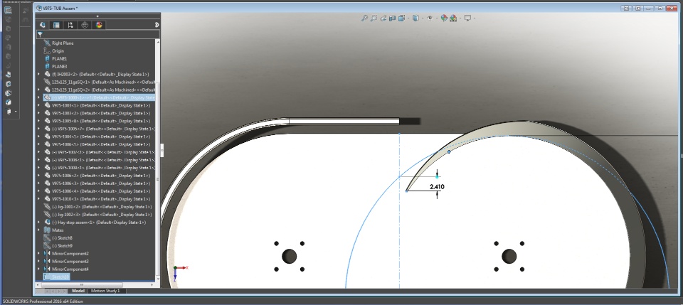

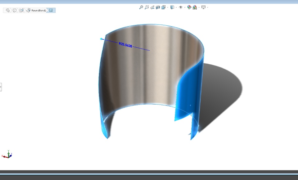

Multiple Radii rolled barrel

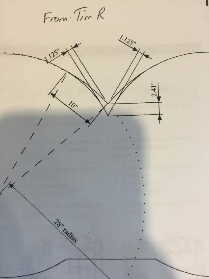

Basically what I'm trying to do is take the corner of the rolled barrel pictured and bend it towards the center, to where it will meet up with a mirrored version of the same barrel. I know the length of the rolled barrel is fine, to where it will meet the barrel on the other side at the correct location and be fine for production. I just need to show my customer that the two barrels will meet directly in the middle, 2.41 inches above where they would meet now. I'll attach the customer supplied drawing as well. This was a revision, and I dont feel like drawing the entire barrel again.
