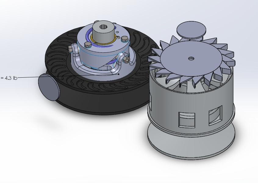

First off, when using the detailed models of the primary and secondary clutches that the company we buy from provided us, I am unable to select them to assign a rotating region. From what I can tell, it has something to do with the complexity of the part? Because if I use a completely smooth dummy model (no fan on the primary), I can assign rotating regions no problem and the simulation will run. Unfortunately that doesn't do me any good, since the dummy models are a lot different from the actual parts. The clutches have a lot of features and gaps where air will get chopped up, in addition to having the fan on front moving air.
These are the models I'm trying to use

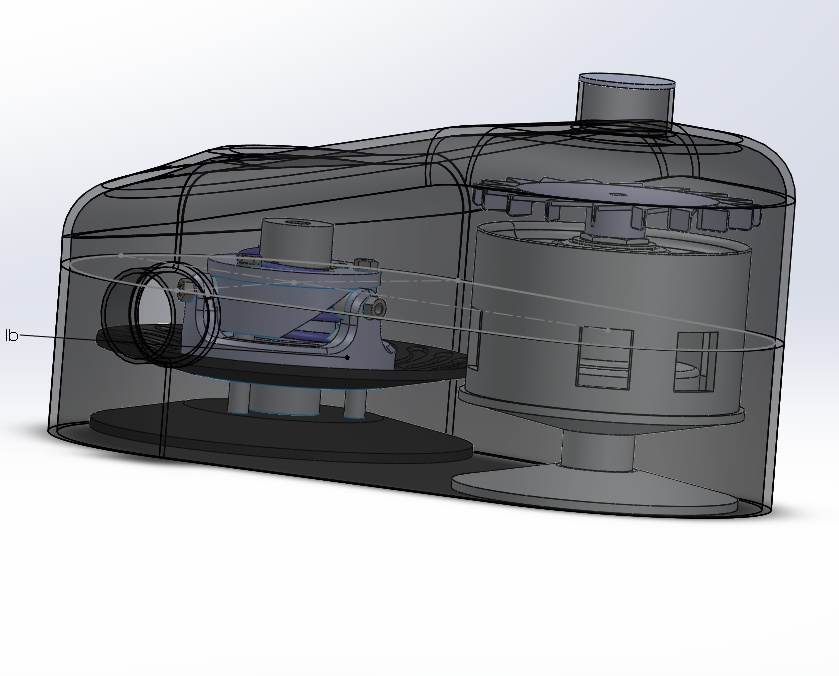

The case that encloses them

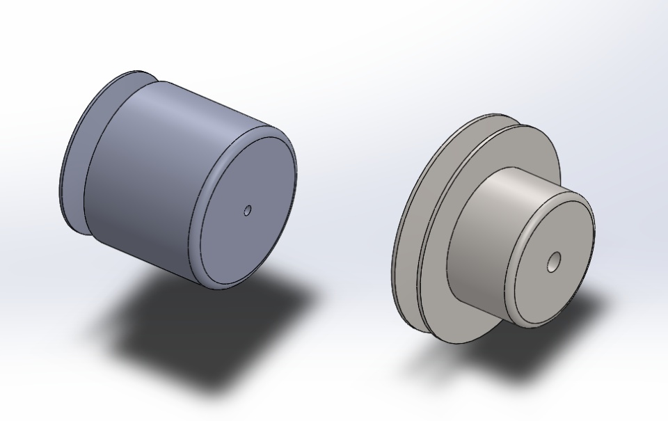

These are the dummy models that work with flow sim. Primary on the left (notice no fan), and secondary on the right.

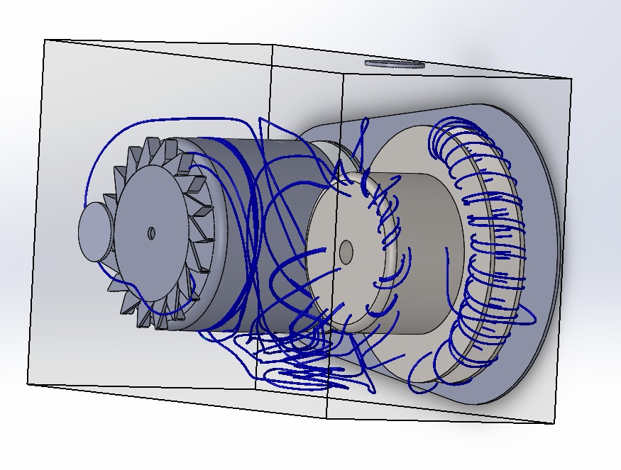

Second off, when I run the flow sim with dummy parts, the flow trajectories originate in the middle of the primary instead of the assigned inlet, the trajectories do not go to the assigned outlet, and they frequently clip through my parts. I can't figure out why this would be happening, so any insight would be helpful.
Notice the flow is starting in the middle of the secondary, instead of coming in the inlet (cap in front of primary). The fan is attached in this one, but the model isn't rotating.
Here we can see the massive amounts of clipping through the pulley halves on the secondary, as well as where the spring body would be.
