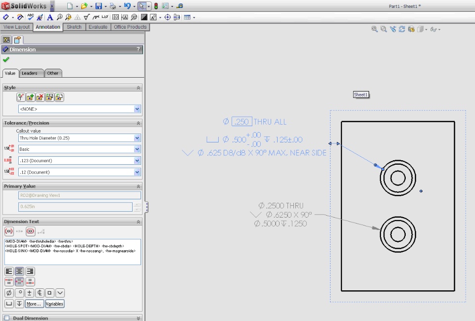

Hello All:
I was wondering if anyone was clever enough to figure out how to do the following:
I would like to create an annoation similar to a hole callout of a counterbored hole done as a hole wizard feature. for the hole wizard feature, I can assign different tollerance schemes for each dimension, but for a feature driven hole I do not have these options.
I would also like to be able to link those values to text in a table if possible.
Is this just a pipe dream?
