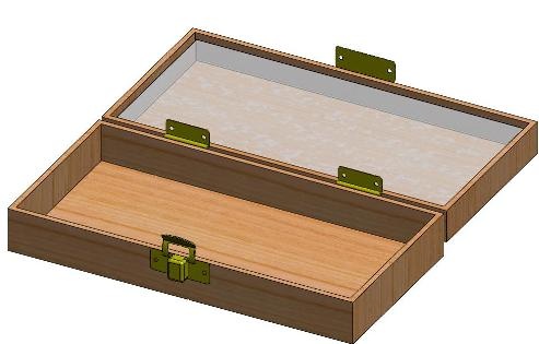

Ok, I am drawing a hinged box. I'd like to show it in the opened and closed positions.
I'm trying to replicate the actual item at the Part Level as oppsed to having it at the Assembly Level.

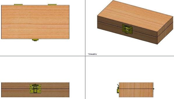

Good so far. Bottom half remains stationary, hinges and latch for bottom are created off the surfaces there.
Everything is as I want it in the closed position.
When I open it, the accessories attached to the top "flip" the desired orientation.
I've tried constrain them several different ways.
Creating a plane from point on the surface I want to use then drawing on that Plane.
Converting entities and relating the sketches back to those, etc..
I still seem to end up with the same results.
Any help on straigtening these issues out is appreciated.
