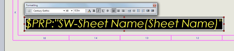

What I've been trying to do is to create a multi-sheet drawing template and use \\\$PRP:"SW-SHEET (SHEET NAME)"
So, on my first sheet, I add the custom property \\\$PRP:"SW-SHEET and position it on the sheet where I want it.

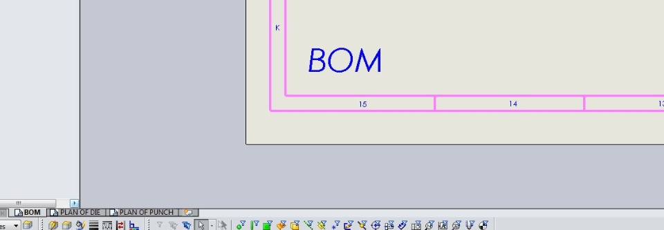

Next, I go and rename my first tab "say.. I rename it BOM. Then save the template and the format. and close.

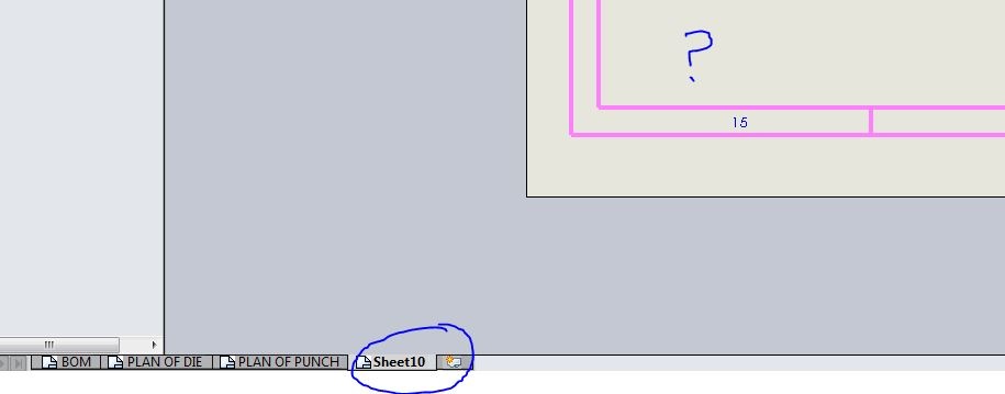

Next, I open up that template, then click the tab new sheet, and open up that template, when I rename that sheet "say.. section view
section view does not populate the drawing. if I create a text and link it, it will show section view.
It loses its link, when I add sheet. I have to recreate it for each sheet.
it should say Sheet 10
Plan of Die and Plan of Punch, I had to recreate. The problems is... I need about 25 sheets names per sheet size.
E,D,C,B,A and a few custom sheets
I would rather, have the sheet name populate as needed. Rather than create a multi-sheet template manually.
