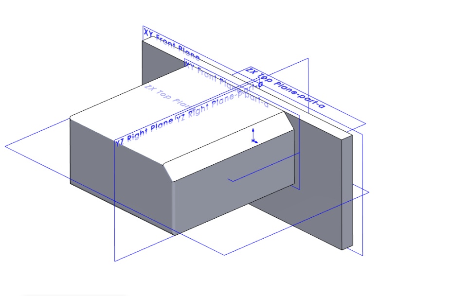

Can you please help me verify a suspected regression in SW2020 SP4. I've attached a SW2019 SP5 and SW2020 SP4 set of parts to test.
The suspected bug in 2020 SP4 (Don't think I saw this in SP3) is that when using Insert Part with the Move/Copy option (or just the Move/Copy feature itself) and using the constrains option, the model does not update when you apply constraints (even thou they are applied) and the model view updates only after you rebuild the feature.
Can you please test for me by deleting the inserted part and then reinserting and mating like shown:
