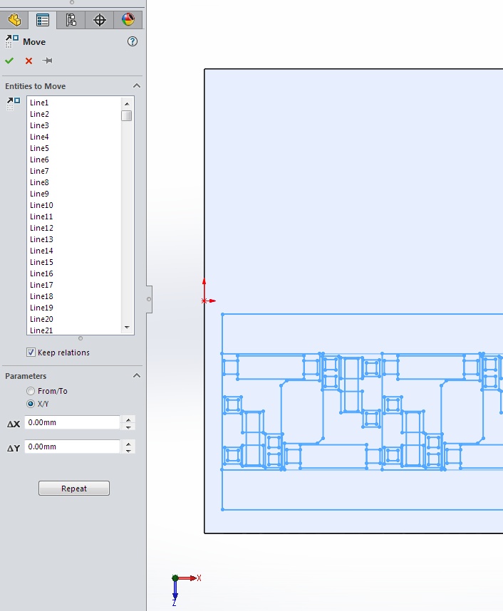

Move a sketch on a non X Y plane
How do you make a numerical move of a sketch which is on the X Z plane. The menu does not update, to the one you work on if it is on a different plane to the standard X Y.
I have submitting an enhancement request number 1-12994273546.
If you are wondering, I did manage it by making a block and dimensioning it from the origin.
