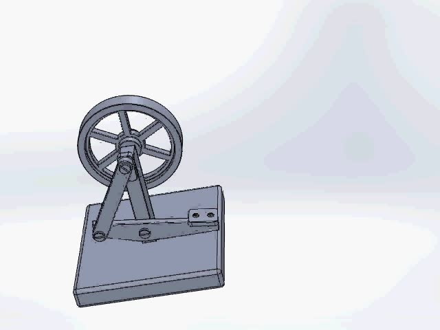

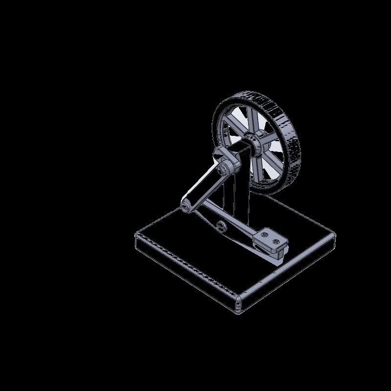

I have made an animation of a finger press engine and the spokes of the fly wheel look like they run in the opposite direction. Look at the key way (if you can see it), it runs in the right direction and the fly wheel is one solid part. What gives?
PS. The AVI version is much nicer, but it too exibits the issues. It is attached.
