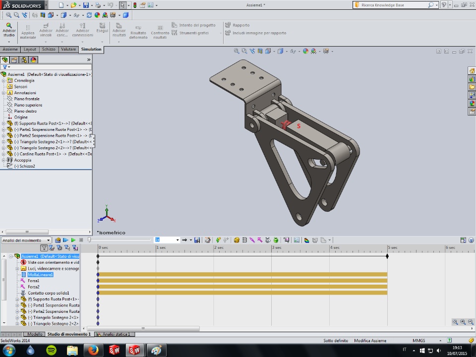

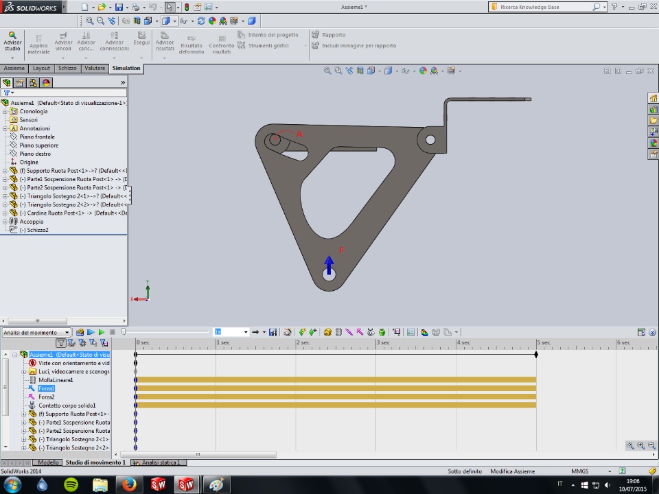

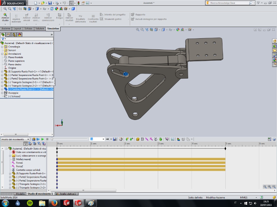

I find difficult to simulate it because the pivot A should slide inside the loop as the reaction F that simulates the weight of the person rotates the "triangle" and compress the spring S.
In the image at the left, the elements behind the S are made to simulate the spring. I linked them to stay horizontal as the Forces rotate the triangles and compress the Spring.

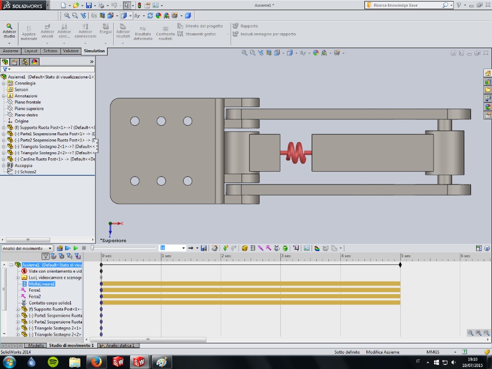

3. I did this screenshot because I have another question. The links between the triangles and the brackets are hinges. Thus the surfaces between the spring and the brackets fit together. Is there a way to make the triangles and the spring central between the brackets?
I want to clarify that if I move the pivot in the loop, the suspension works fine.
When I simulate, when i calculate the simulation, nothing happens: the assembly stay still!
Can you help me?
