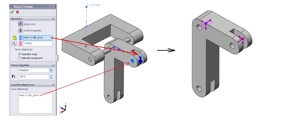

Hi, could anyone help me with "load bearing faces" function while defining the force in Motion analyse? I try to use this function, but anyhow there is no effect when importing motion forces into part FEM. The load is still only on the primarily selected face. The same behaviour is also while applying this function for mates (also it doesn't transfer the load to the selected bearing faces).
