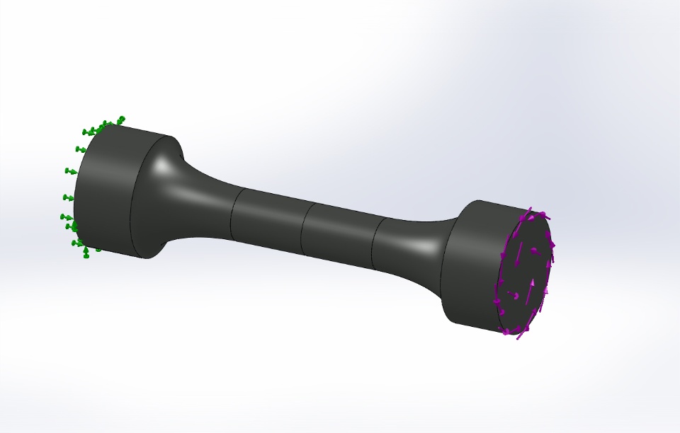

I tried to use it on a simple case: a torque applied to a rod
I mesh and run a static analysis. And then I visualyse the criteria value of the center area

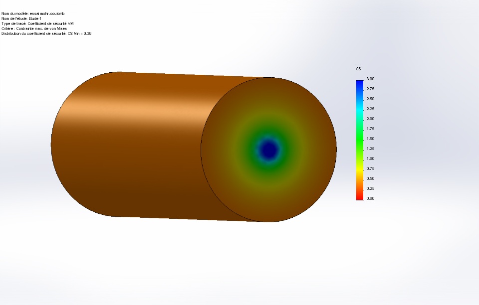

Firsly  I visualise the Von Mises security criteria distribution:
The result is coherent as it show an high coefficient in the center of the rod which decrease when we go to the periphery of the rod.

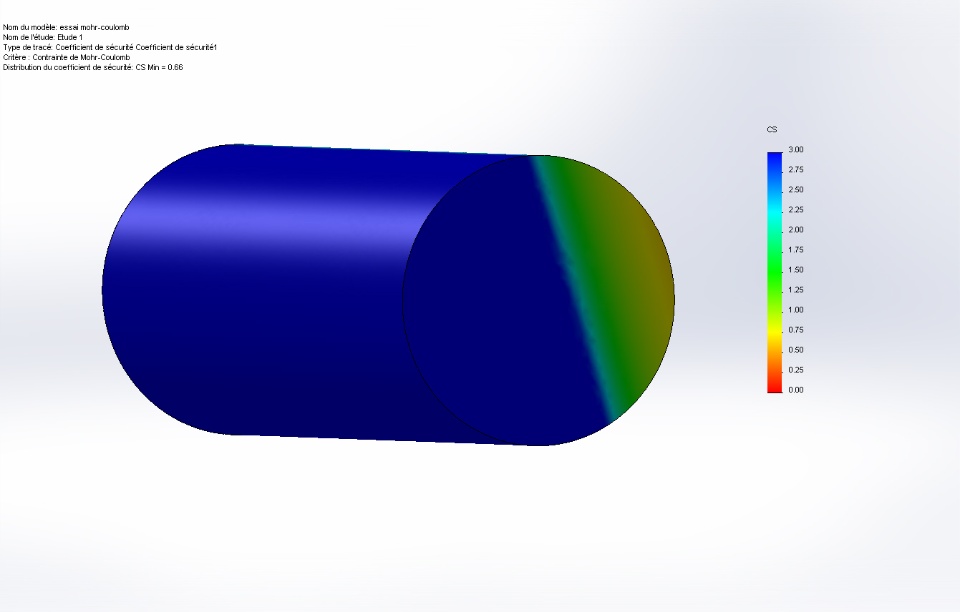

Secondly , I visualise the Mohr coulomb criteria distribution:
I can't explain the result! according to me this doesn't have any sense?!
Is there a bug in solidworks?
