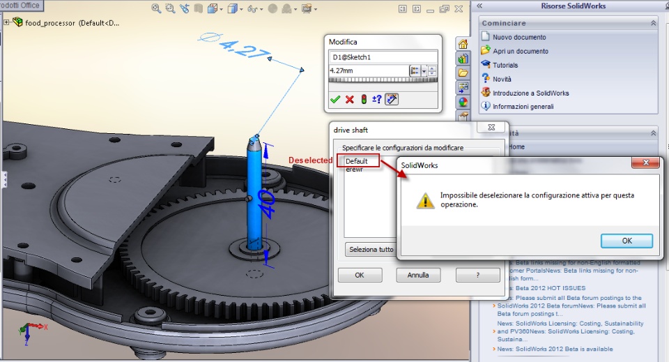

In an assembly with a component that has multiple configurations, double-click a dimension
that has a different value for each configuration. In the Modify dialog box, you can set a
new value for the dimension and specify to which configurations the change applies.
I tryed but nothing.
Where I wrong ?
Please see the attached image.
