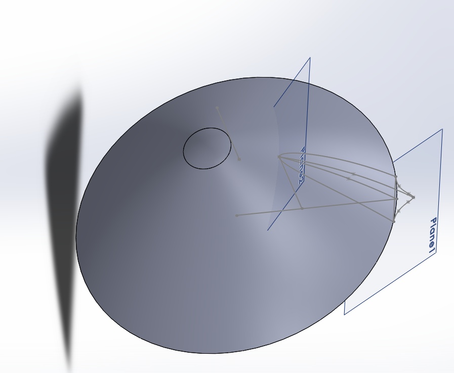

Hi,
I am currently trying to model a limpet shell. i have made many generalisations around the shape, and have created a conical shape with a curved lid and mildly curved sides. i am now trying to model the ribs that run down the outside of the shell but cannot find an effective way to create these as solid features. i have tried to loft base/boss the outline of the rib curvatures on the right of the image but keep getting an error to do with zero thickness. no other method i have tried seems to be able to achieve the geometries i want, which is a rib that contours to the cone curves. the model must be solid and not simply surfaces as it is intended for simulations.
