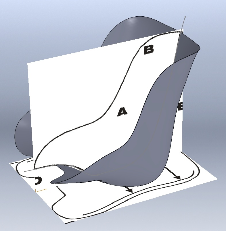

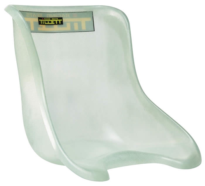

Something I have been looking at for a while is modelling of a race seat, but so far have not come up with an accurate and robust way of approaching this (am quite new to SW).
The seat in question is a Tillet T9.5XL
I initially attemped to use the 'blueprints' method, sketching multiple profiles, then using them to control a surface.. I created a 3D sketch for the rim, created a Surface Fill then used the freeform function to pull the surface (quite innacurately) into shape. Kind of.
I would be interested to know whether anyone would have a different method than this to create the seat moulding with the edge rim, and have it adaptive, symmetrical, accurate and parametrically driven. I have the seat in question at my disposal, so measuring to create a series of sketches through the part is also an option.

Might I suggest the Razor and Game Controller first. They are probably closest to what you need.
To answer your question directly, I think your sketching is probably in the right direction. I would start with using boundary surface through the main part (meaning the mid-section, where it ends is ambiguous). Then fill the ends with the filled surface tool. If I get a chance after lunch I will try and look at your part and post a sample. Unfortunately I am very busy and might not get a chance.

Matt Lombard modeled a somewhat similar seat in his blog:
http://www.dezignstuff.com/blog/?p=2081
I would stay away from Freeform and probably use Boundary Surfaces for most of the areas, with Fill where needed.
In addition to the stuff that Charles mentioned, Matt's SolidWorks Surfacing Bible is a really good resource and cheap for what you get. Another resource that might help are Ed Eaton's Curvy Stuff tutorials:
http://www.dimontegroup.com/Tutorials/SolidWorks_Tutorials.htm
They go back quite a ways, so they don't cover newer stuff, like Boundary Surface, except for a little bit in the latest ones, but they give a good grounding in the basics. You can usually use a Boundary Surface anywhere that you would have used a Loft, although there are some special cases that still require a Loft and sometimes a Loft will work unexpectedly better than a Boundary Surface.
The main trick to a project like this is visualizing how to split the surfaces up into the best pieces to make the software work best.

Do you have a front view jpg by any chance?

Unfortunately I dont have the front jpg, and I am not even sure the other two views snipped from the catalogue) are anything more than a hand sketch to give general information. I could possibly do a few narrow perspective photos from the real thing, to generate the three images.
