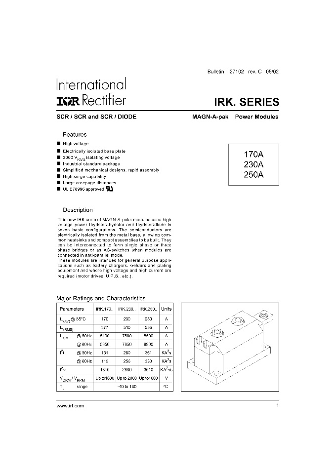

My company uses a great deal of IGBT and SCR's where the junction temps is critical to the survival of our power conversion units. (I have attached a cut sheet to one of our more common parts)
My quandary is in how (in the heck) to model these parts in FLOW because we do not have any specific material data from the component manufacturer. In most cases, they provided us with (highly suspect) thermal resistance coefficients between junction and case and between the case and the heatsink.
For those of you still reading this....good on you and thanks..... I can empirically measure the temp at the base of the component sitting on top of the heat sink and the case of the device. But, I have to backward calculate the temp of the junction which is not hard. But, I want to be able to use flow to predict the temp of the case because these little buggers and others like them are mounted such that convective flow heats the component mounted above it.
SO.............
My original thought was to take our existing SWx models, used as space claims, and make them multi-body. From there I can apply a material to the metal  base (no big deal) but I have no idea what the material of the case is. This means I would have to keep futzing with a user created material until I get a case temp in FLOW that matches what we measure real world.
Can anyone else think of a better (spelled e-a-s-i-e-r) way to do this?

What I do is take the specified resistance, the amount of power (thermal) and calculate the case temp. I run some quick conduction simulations to figure out the equivalent conductivity in the componet to produce the desire temp maximum and then use that for the component value. I am doing this in Simulation as opposed to flow - just cause it is faster and I am working on a conduction probelm at the moment. Not positive this is the way to go as the equivalent k seemed a bit high (106 W/mK). I normally use 18W/mK for IC's as a general rule........but then again it was pumping out 50W so hopefully the manufacturer did realize good conductivity was important. They said the equivalent resistance was based on the two resistor model.

They typically give you (2) thermal resistances.  (1) from the case of the scr to the heatsink and (1) from the case to the junction. It may go without saying, but there is no way to actually measure the temperature of the junction.  The case (I believe) is the base portion of the heatsink.
So, what do you think of this:
1. Model the SCR as a multibody part.
2. Assign Aluminum to the base/case(part that sits on the heatsink) and make it a volumetric heat source
3. Assign the default insulator material to the top of the SCR and see where we stand.

The JEDEC model for a 3D representation of a 2 resistor model would be a stack of resistor bottom, high conductor, resistor top (insulators around the sides depending on what is going on/tool in use). You would add the heat source to the high conductor part - say 2 or 3 orders of magnitude higher conductivity that the most conductive resistor - so it is at more or less constant temp through out (like a node in a 2 resistor model). The bottom goes to board, top to whatever is on top of it, if anything.
