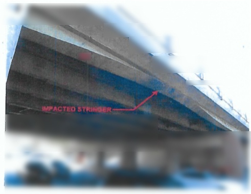

I am working with an experienced SW professional to develop a plastic deformation model of a 54' long x 24 inch high I beam with 12" flanges 3/4" nominal thickness -  Bridge beam - that has two intermediate stiffeners along the length which are welded at web of I beam.  These connect to the next beam, etc, for a total of 12 which form the support of the roadbed and utility, sidewalk, etc... .
the top flanges are fixed into concrete roadbed and ends are secured at abutments, I am going to assume ridged- ?

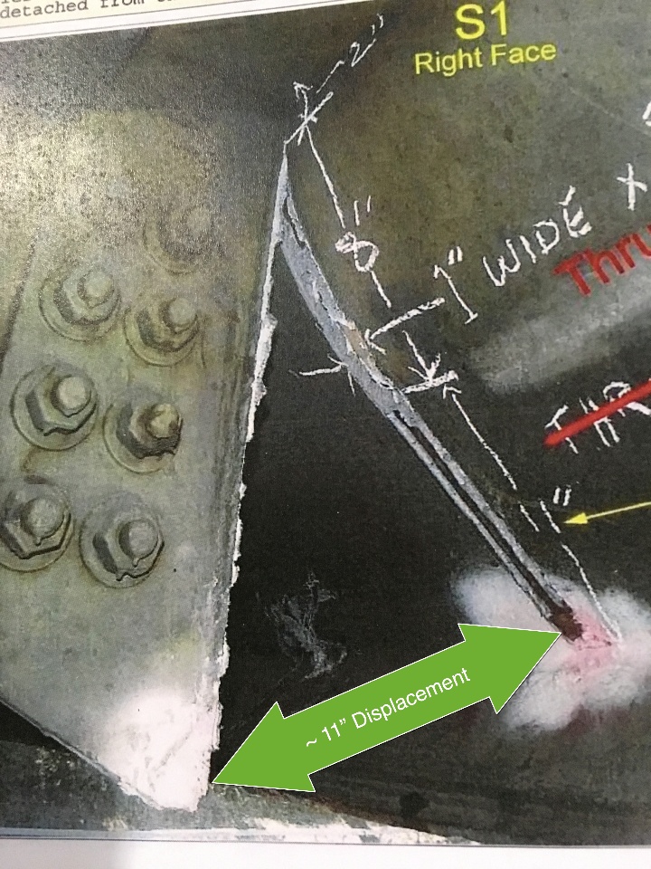

The 'last' beam of the network was 'impacted' at a location approximately 1/3 of its length outwardly (but between the stiffeners) approximately and underwent a significant amount of plastic deformation over at least 20' of its length (with significant local plastic deformation at point of impact) - bottom flange , which was point of impact, rotated nearly to 45 degrees at the point of impact and displaced on the order of 11" from its starting position on the 'bottom' of I Beam ( i.e. a Bent Ribbon) - the welds at the intermediate stiffeners 'unzipped' and failed where web underwent plastic deformation (all but ~2" at top of stiffener to web) , the beam bowed over much of its length and there is axial torsion as described above.
unzipped weld:
