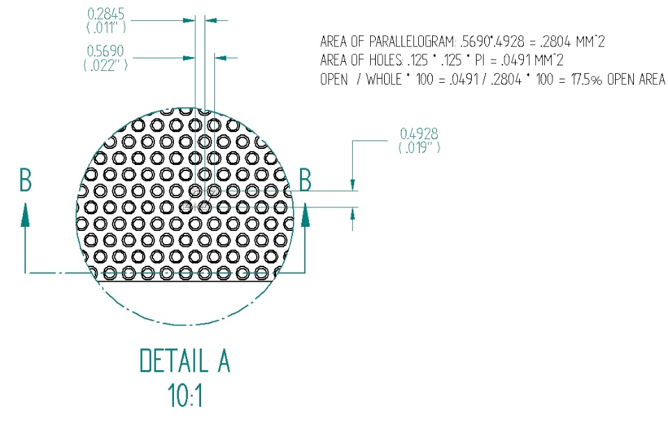

I need to model a highly detailed screen. I wish to create an STL file for 3D printing, so it must have every detail. I want to create a screen with many small holes. The part size is 410mm x 210mm with 0.3MM holes that are approximately 0.5MM on center. These holes are tapered, they are not simple through holes. The problem is that the software seemingly cannot handle such a task. I've tried modeling this several ways:
1. The simplest approach, using a pattern fill. This causes the software to freeze and eventually crash.
2. Modeling the smallest repeating unit and using a linear pattern of bodies. This works only while the body count is relatively low. I've managed to use this technique with limited success, building the pattern, merging the bodies, then repeating. This technique ultimately fails well before I have completed the entire 410x210 pattern.
Any ideas? Is this simply not feasible using SolidWorks?

Wow!  The 3D printer will have its work cut out for it with that fine detail.  Good luck with the holes.
Regarding the modeling - since you MUST have a complete model for the printer your best bet is to detail a small portion.  Detailing something bigger will just bog the software down.  I know, I've done something similar to what you are doing.  Here's the trick.  Instead of trying to do this in a single part file you'll be better off creating an assembly and patterning these small portions .  Patterning is a joy in SWX.  I might suggest you have your part detail boundaries slightly larger than the pattern spacing so they physically overlap in the assembly.  You can even do a perimeter trim in the assembly to get your edges the way you want.  Now you can either save out your assembly as a single Parasolid or you might be able to directly save it as an STL file for your printer.
