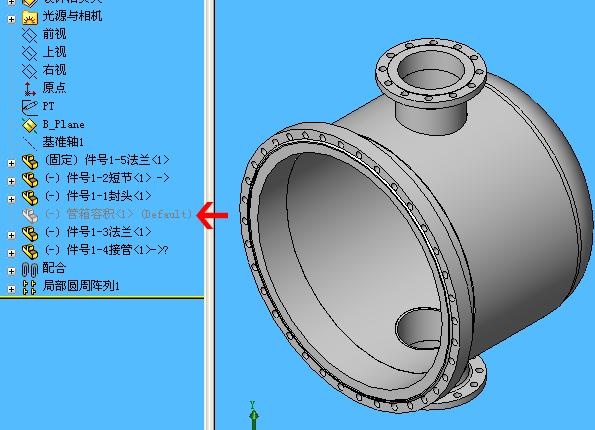

    ' Suppress what has been selected
    bRet = swModel.EditSuppress2: Debug.Assert bRet
End Sub

Another program method
Dim swApp As Object
Dim Part As Object
Dim SelMgr As Object
Dim boolstatus As Boolean
Dim longstatus As Long, longwarnings As Long
Dim Feature As Object
Sub main()
Set Part = swApp.ActiveDoc
Set SelMgr = Part.SelectionManager
boolstatus = Part.Extension.SelectByID2("管箱容积-1@件号1管箱", "COMPONENT", 0, 0, 0, False, 0, Nothing, 0)
Part.EditSuppress
Part.ClearSelection2 True
End Sub
