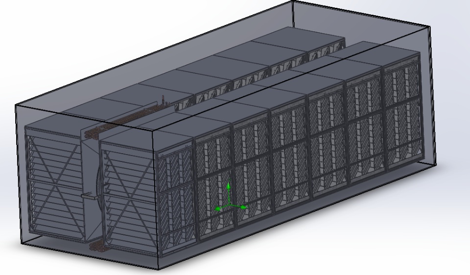

I have been experiencing a very weird problem. My model contains 14 racks placed in a cabin. Each rack has 45 flat plates on it, which act as heat sources. I also have three fan profiles made with rotating regions, as well as cooling coils that act as heat sinks. The flow is internal. Attached is a general picture of the setup.
