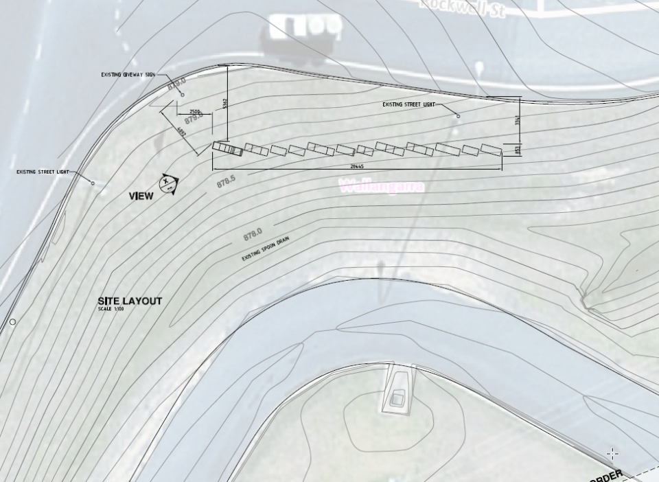

I'm working on a proposed entry statement sign, and need to make sure that the sign will look good in location. I have a topo map, and want to know the easiest way of modelling slope.
I plan to insert the image, scaled correctly, on a sketch in a part.
Create planes at 100mm increments
Sketch contours on planes, using splines
Use sketches to create a lofted surface
Anyone know an easier way?
