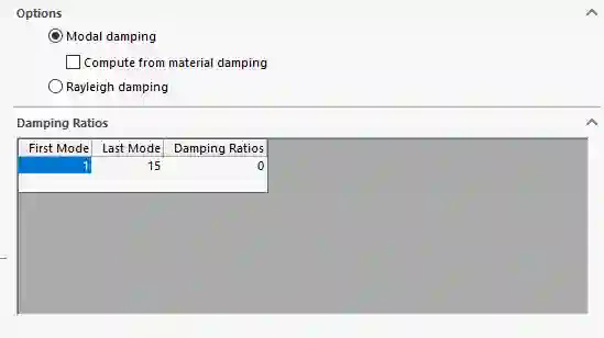

I have a question regarding the modal damping option in the simulation studies. In linear dynamic analysis there are three options to set for the global damping:
I know, what Rayleigh damping is and also the theory about modal damping and that I can set it for each respective mode. I assume, that I put values here for the entire system so for example for a metal structure with joints 0.03 - 0.07 according to:
But I wonder about the option "Compute from material damping". Does anyone know, how exaclty this is done? I can specify the MDAMP (material damping ratio) in the properties of a material, but I do not know which value I should put here. Is it the equivalent viscous material damping ratio, I can also find in the literature or in the table given above, so for example 0.5 e-04 for aluminum?
And maybe someone has an idea, how exaclty the solver computes then the modal damping ratio from this material parameter. Regarding that, I only found out about "Composite Modal Damping", which seems to be the procedure for this option. However, the documentation is very short on the website. And also it says: "If you specify material damping ratio MDAMP to be m for all materials in the model, the equivalent modal damping ratio will be m for all modes." This confuses me, because it would mean that it directly uses the material damping ratio which would be too low for the entire system.

There are several DS Knowledge Base (KB) articles on this topic which may help you:
Article ID: QA00000116506
Abstract: How do I calculate the damping ratio for modal damping and material damping?
Link: https://support.3ds.com/knowledge-base/?q=docid:QA00000116506
Article ID: QA00000119306
Abstract: Where do I find the equivalent modal damping ratios that the software calculates and uses when I select the 'Compute from material damping' option?
Link: https://support.3ds.com/knowledge-base/?q=docid:QA00000119306
Article ID: QA00000122482
Abstract: When using different damper values in a 'Dynamic Analysis' with ‘Composite Modal Damping’, why do I see the same displacement values?
Link: https://support.3ds.com/knowledge-base/?q=docid:QA00000122482
