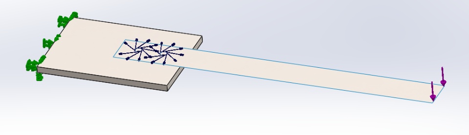

I have a question. I have been working on simulation for some time. But when it comes to Mixed mesh I am always little bit confused. Let me write down my queries. Below is an simple example of mixed mesh study. Hope it clarifies all boundary conditions.
Now There is 2 method I know for mixed mesh. Top part is a surface and bottom is a solid. Both are 10 mm thick. Now if I want to run the analysis, best way is : surface should be at a distance of 5mm from the top of the solid face as when i want to apply thickness it would be both side 5 + 5 mm = 10mm.

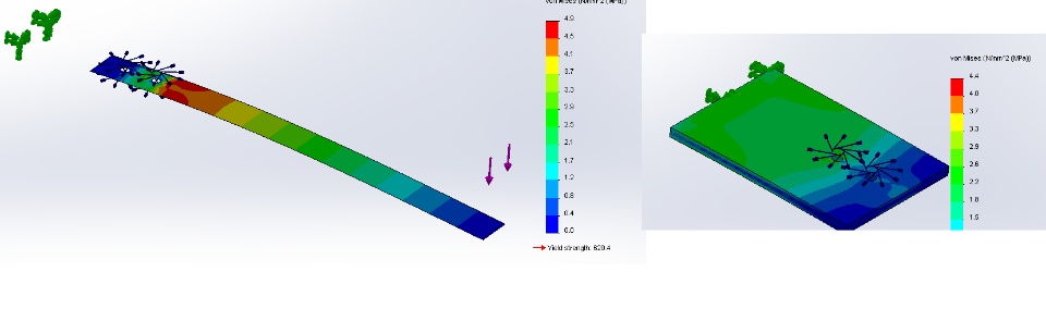

Result is below.

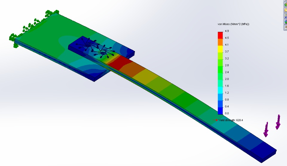

Another method is surface should coincide with the solid face. there is no gap between them. And from the result we can see tha the stresses are coming approx same.

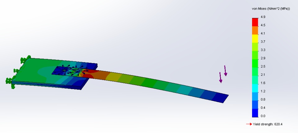

Now lets see the solid model result.
Now for top 3 different cases, though the stress are aprox similar, but the Plots are kind of different. So Please let me know as we are sure that solid mesh is perfect solution but which is the best option to choose for mixed mesh.

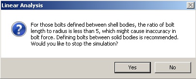

Also when we use bolt connection between this kind of arrangement i always get this warning message, should I ignore that. Please advice.
