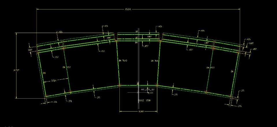

I am recreating a lower portion of a sheet metal hand sink. (also known as a skirt). It was modeled in pro and flat pattern created in PROE.
I was not able to convert to sheet metal, due to the way it was created in proe. Edges touching, and just basically fudged
I used the original flat pattern to get the base shape and used sketched bends to fold it in 4 places, then add the top and bottom flanges

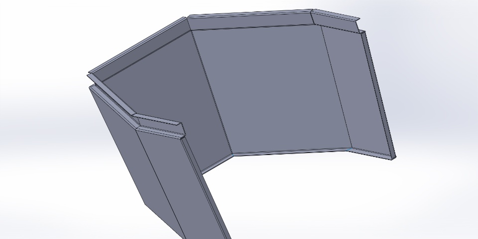

The issue I am running into is that since body has several  lofted style bends at an angle it creates a radii which wont allow me to use a single mitre flange along the top
Using multiple edge bends sort of works, but I now i have to play with 3 different gap adjustments, corner features to try to get it all close to minimal gap.  i'd rather have sw treat it as 1 single mitre and let it handle the gap and reliefs
Or
another option i'm thinking is  to figure out of there is a way to draw the whole section profile, then  insert sketch bends and bend the whole thing in 4 places.

Oliver,
is this something you are after ? Did not finish though.

Olivier,
Ingvar may have the answer you need, but I can't open his file (future version) to look.
I opened your stp file and put it in an assembly so I could (the stp import wouldn't save so I had to save-as to a parasolid and re-import) "make an incontext SW copy.  I tried making a "start with a Base-Flange" sheet metal part and found that it wasn't really that hard, however I have done a lot of that sort of thing.
After looking at that overall shape a little more I decided to try the "make a solid and convert to sheet metal"  part, that worked surprisingly well.  Have a look at the SW part in the attached Assem2.
