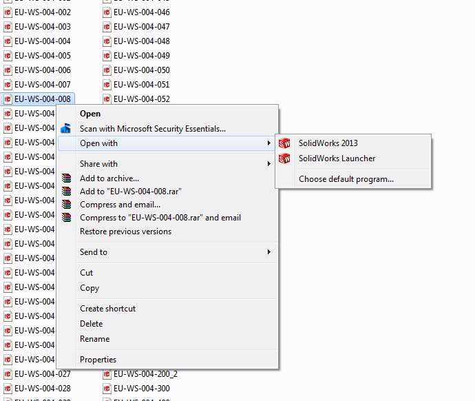

I am missing this SW Explorer extension. When you click on a SW file in Windows explorer, there was a menu for pack&go/rename etc., but now it's missing.
Also, all of my SW file icons look the same (see attached screenshoot).
I tried registering dll's, reinstalling SW, repairing SW explorer. Nothing works.
As you can see, I have two options, when opening SW files.
I had this problem a long time ago, I remember, I could fix it by choosing to open SW files with SW launcher by default.
Now it is not working.
And also, when one session of SW is running, when I double click SW file in explorer, it opens another session.
This is really driving me nuts, I hate to use SW explorer to rename every SW file. And as you can see, i can not see which file is a drawing, part or assembly.
