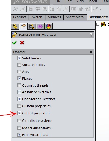

I have used the Mirror Part... command to create some mirrored weldments. I began created the drawing for one of the mirrored parts and the cut list came in empty. I assumed that the "Cut list properties" check box was unchecked in the transfer options. I had been experimenting between the frustrations of transferring cut list properties and SW preventing me from being able edit them or NOT transferring and SW not creating them. You can have the hotdog with grape jelly or you can go hungry... but I digress. So when I edited the mirrored body feature the "Cut list properties" option is not even there? Does anyone have any thoughts on what might make SW remove it?

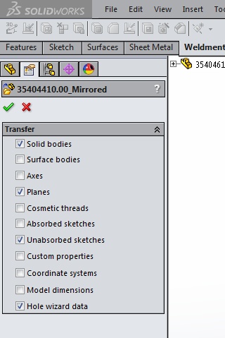

The culprit seems to be the original weldment. I tried creating another mirrored part from it as an experiment and "Cut list properties" is not offered as an option.
