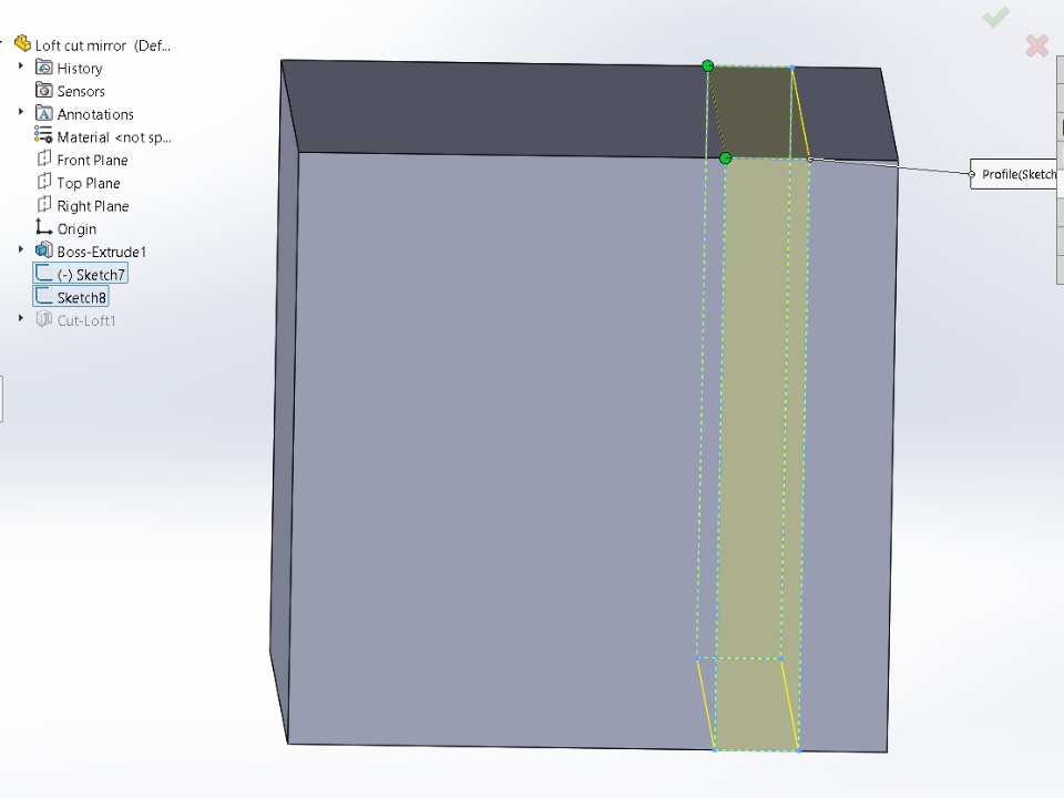

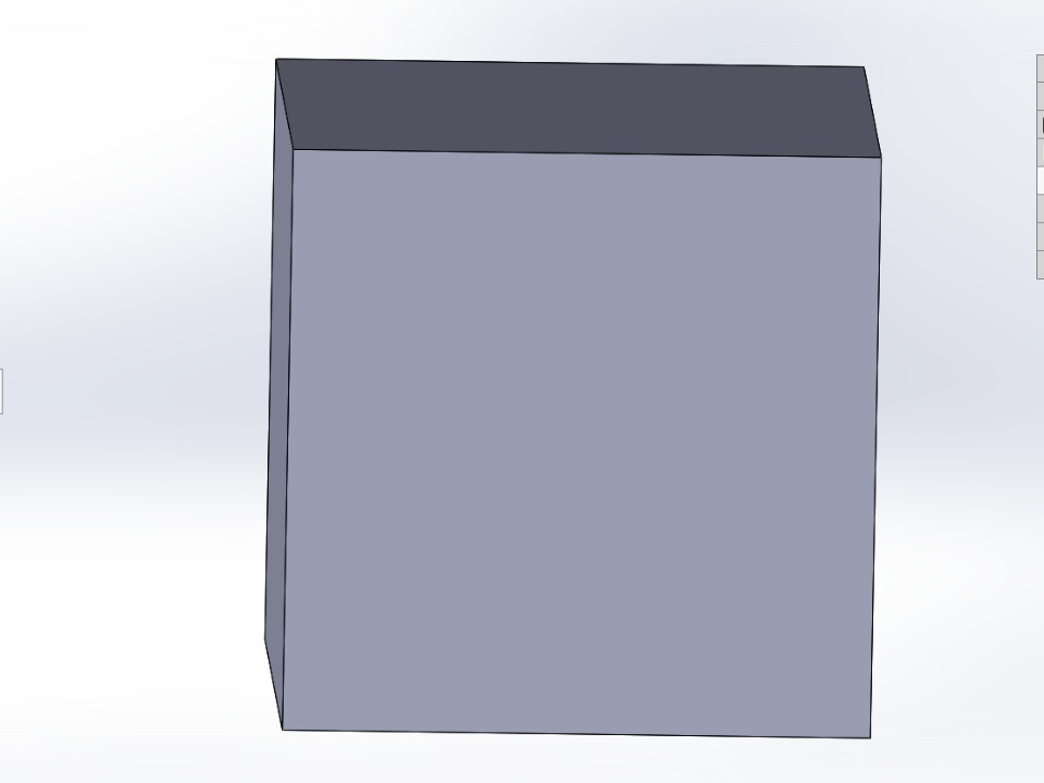

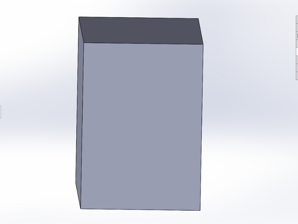

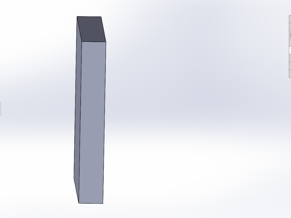

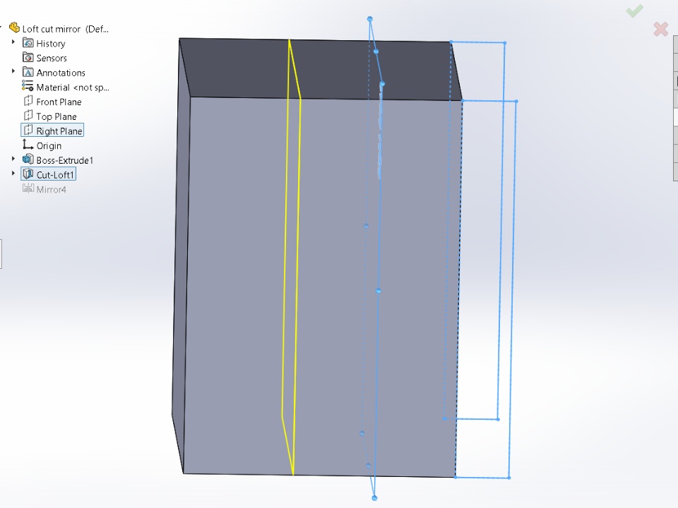

If a lofted cut is made in a part with separates it into 2 or more bodies (Figure 2) and then that lofted cut is mirrored (Figure 4), which again separates the part into 2 or more bodies (Figure 5), then which of the final bodies is keep can't be chosen. SolidWorks will keep one, delete the rest, and not give the user a say in which one it chooses. Am I missing something or is this a problem with SolidWorks? An example file is attached below.
     Figure 1. Initial part
     Figure 2. Lofted cut
     Figure 3. One body is selected to be kept
     Figure 4. Mirror of Lofted cut
     Figure 5. User is given no choice over which body is kept.
