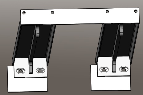

I have been working on a assembly that is going to be symmetric about a plane....So I build one half of it and then mirror all the parts that need to go on the other side.......
As most of you may know that there is a need for a "opposite hand version" of some if not all of the parts.  In this assembly all the parts are flat plate...and I am using the mirror to keep from having to double the time to copy and mate all the parts again.
After playing with the mirror function one of the plates was going to need the opposite hand version to show up properly.  Instead of letting the program make another part...I decided to leave this one part out of the mirror and add another part and just mate it up to where it will fit up properly.
What do most of you do when you mirror something and the program shows that you need a opposite hand version? Do you just go with it or see if you can really use the existing part?

I can usually get what I need by individually selecting the components I want opposite hand vs. a regular mirror:
But you are right having all of those opposite hand parts does bother me.  So, I usually do as you state and mate up or make another part in that location.

The way I handle mirrored components it to make my own, by opening the part and going Insert/Mirror Part and then insert the part into the assembly and mate..  I have tried the mirror feature in assemblies, but never had good results, but most likely a lack of training be the biggest factor.  I go with what was successful for me in the past and works well today..

Going through the options for the orientation of the mirrored part can sometimes help too.  See #24 at .

I guess I don't understand the question fully. I almost never use the mirror function except the opposite hand version.  Its the only one I ever use.  I guess the main reason is that the opposite hand version is the most intuitive mirror (the others sometimes confuse me as to how they came up with what they are coming up with (I mean the "reorient components" arrows)) and can be exported as a separate part very easily.  And if I am mirroring a component, then I am going to need a separate print for that mirrored component (no mirror image notes here).  Which means I need a separate part (or at least a separate configuration).

I use the assembly Mirror Components pattern all the time.  It can be a real time saver when the components are the same just assembled opposite.  If I run across a situation where an opposite hand component is required I create a new part and mate it in separately.  Over the years I have found using the Mirror Part is more hassle than it is worth.  It seems every time I used mirror part I would have to make a small change to one hand but since it is "in-context" I needed to redesign.  This always caused mate issues in the assemblies that had to be fixed as well.

Have to mess with orientation issues for multiple components, But still a time saver command in large assemblies
