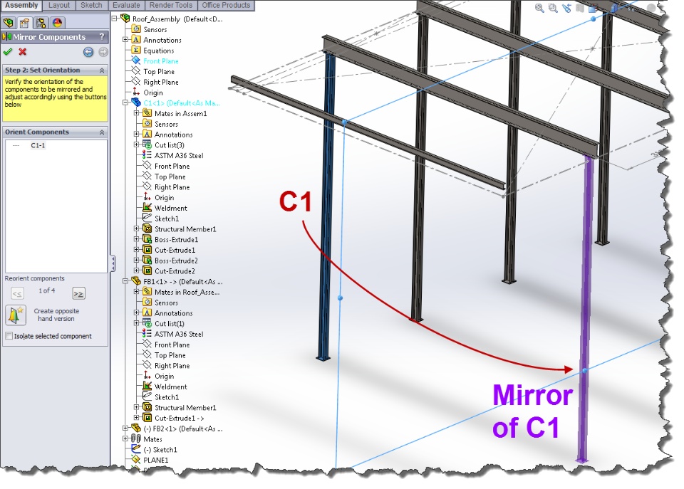

Mirror and make non-dependent component
Hello everyone
I have a project where I need to mirror a component, but after that I want to modify the component without effecting the source component. Is that possible or I need to make a copy of the original component and then modify the new one?
