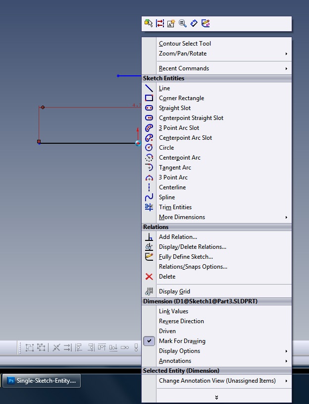

I have come across a minor anomaly with the sketcher.

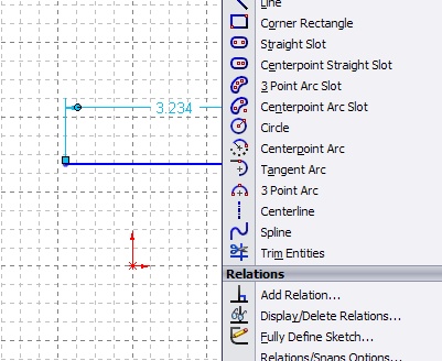

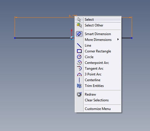

If you have a sketch with a single sketch entity (e.g. single line) and you then dimension that entity, then right-clicking the dimension will yield a truncated list of options.  If another sketch entity (e.g. another line) is added -- whether dimensioned or not -- then the standard set of options are presented.  If you then delete the second entity, the behavior remains the same and the complete list of options is presented.  Please see attachments for examples.
While I understand that some options (in particular relations) can only occur with two entities, other options like Link Values (assuming that one is linking to an already created equation), Mark For Drawing, Display Options, and Annotations are certainly valid.  Admittedly this is a bit obscure, but I "stumbled" across this by creating a circle at the origin (for a boss) with a given diameter.  When I tried to move the dimension away from the origin by turning off the Center Dimension option, I found that I couldn't.
Is anyone else seeing this?
